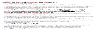

@TanmeyTWX
The SSL configuration is defined in tomcat server.xml file located in tomcat\conf directory. You can check there if SSL is configured or not.
If your login URL and redirect URL are of the same server then I think SSL is configured.
Even if you don't want to use https then you should use the non secure port with http which is 8080 by default, you can verify the port in same server.xml file, look for Connector port(first line in above screenshot.) Use that port in the redirect URL http://MyServer:<yourPort>/Thingworx/FormLogin/MyOrganization/
Basically you cannot use same port for both http and https. On my local instance I have SSL configured i.e. https on 8443 and http on 8080 and when I tried to access Thingworx on 8443 using http I got the same error.

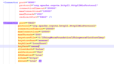

Sachin,
Are you saying that both Connector and Redirect ports should be of same type i.e  if Connector port is HTTPS then redirect port should also be HTTPS?
Hi @VladimirN,
The port I am using (8443) is already a TLS port still it is throwing error on redirecting.
Do I need to set both connector and redirect port as 8443? Below is the tomcat server configuration.
