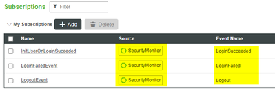

Regarding Session started / ended: The "SecurityMonitor" has events you can subscribe to
But this is specific to the whole platform - not to the mashup you'd like to have. I am also not sure, if a session timeout creates a Logout event (e.g. user was inactive for 30 minutes). So just as a FYI.
