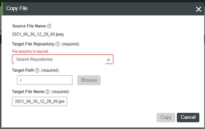

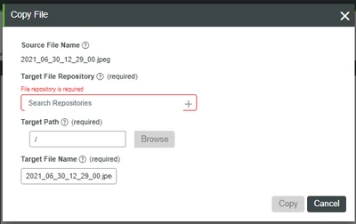

What function do I call to move a file from one repository to another. I have tried 'MoveFile', but that only seems to work when moving files from directory to another inside the same repository. I want to utilise the same functionality that can be accessed through the backend GUI in the repositories from within my service. Is this possible?

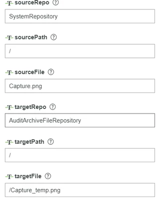

Best answer by Sathishkumar_C
Use the following service...
FileTransferSubsystem > Copy
// result: INFOTABLE dataShape: "FileTransferJob"
let result = Subsystems["FileTransferSubsystem"].Copy({
	async: undefined /* BOOLEAN */,
	sourceRepo: undefined /* STRING */,
	metadata: undefined /* JSON */,
	targetRepo: undefined /* STRING */,
	targetFile: undefined /* STRING */,
	targetPath: undefined /* STRING */,
	queueable: undefined /* BOOLEAN */,
	sourceFile: undefined /* STRING */,
	sourcePath: undefined /* STRING */,
	timeout: undefined /* INTEGER */
