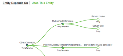

Hello.
As WindchillConnector entity is meant to disappear, we plan to follow PTC's suggestion to use ODataConnector instead.
Currently, we have about fifty custom REST services, configured in a ThingTemplate implementing WindchillConnector. Then we have one thing for each server configuration, as we have several of them.
I struggle to replicate the same architecture with ODataConnector. Article CS284781 tells that custom REST services endpoints are enabled with ODataConnector property SwaggerJSON. It's impossible to do so within a ThingTemplate, but only in a Thing.
How can I separate services declaration and server configuration?

Hello.
I'm using ThingWorx Foundation and Navigate 9.1. WindchillConnector is a (deprecated) ThingTemplate, not a thing, and has nothing to do with ODataConnector. I have no idea what is this "WindchillConnector" thing you have under ODataConnector. Isn't it something custom? Look what I have :
But never mind WindchillConnector.
Now imagine I have two servers: ServerLondon and ServerParis. I create a ThingTemplate named "MyConnectorTemplate". I made a picture describing the architecture I want:
I want my services to be declared on MyConnectorTemplate, and servers configurations set in their Thing.
I can't to that, because I can't define custom EndPoints at ThingTemplate level (Cf. CS284781 article). For what I know one can only redefine EndPoints in a Thing, which would only be acceptable if I had only one server.
I am not familiar with Navigate 9.1 or what WindchillConnector was replaced with so I suggest you open support case with Navigate support team that can suggest appropriate solution.
