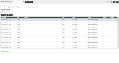

What messages do you see in the Application log?
iman
(To:PaiChung)
Simply just an Error without any description in the content, as it can be seen in the following screenshot.
Application LogApplication Log
