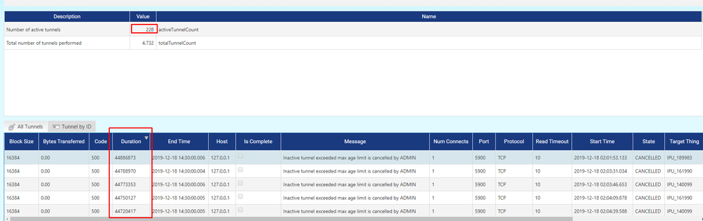

The system is still working, however the number of active tunnels keep going up and never down since yesterday. The GetActiveTunnels also returns the same result.
I don't know what's going on, any advice would be really appreciated!

Can you provide more details on the use case?  It appears the tunnels are being kept open for the max amount of time resulting in a timeout.  Which version of ThingWorx are you running?

This is a timeout issue. While the server is under load, tunnel communication might take longer than 10 seconds and a timeout occurred. In that event, server still keeps the tunnel session in the Active list while that's already disconnected.
Edge logs
{"level":"FORCE","timestamp":"2019-12-17T11:48:00,664","origin":"SDK","content":"TUNNEL CREATED. Entity: IPU_TEST, tid: 71d70bae-2994-4ebe-a971-efa2362f3dfb, target: 127.0.0.1:5900"}
{"level":"FORCE","timestamp":"2019-12-17T11:48:10,466","origin":"SDK","content":"TUNNEL STARTED. Entity: IPU_TEST, tid: 71d70bae-2994-4ebe-a971-efa2362f3dfb, target: 127.0.0.1:5900"}
{"level":"FORCE","timestamp":"2019-12-17T11:48:11,406","origin":"SDK","content":"TUNNEL ENDED. Entity: IPU_TEST, Peer: TEST, tid: 71d70bae-2994-4ebe-a971-efa2362f3dfb, target: 127.0.0.1:5900"}
and server logs
2019-12-17 11:48:11.556-0600 [L: ERROR] [O: c.t.w.t.WSTunnelServer] [I: ] [U: ] [S: ] [T: http-nio-0.0.0.0-443-exec-820] Error occurred in web socket: An existing connection was forcibly closed by the remote host
I bet that when the local socket read timeout (Default is 10 seconds) occurs, the tunnel is immediately ended. While it should give a few chances before terminating the tunnel. The current implementation is causing a lot of issues while the server is under load.
