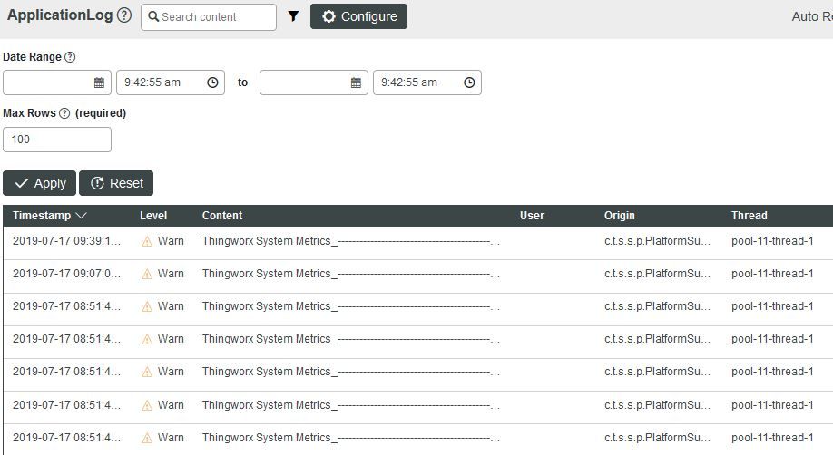

Have you tried looking at the application log and adding some logger statements to the services you are calling to help with the troubleshooting?
Yes, I am looking for some help to troubleshoot my POST request.
I am new to API and post request.
When I check my application log I have only log about my thingworx metrics that i have used for some test but I no longer need it.
Is there a way to see all the request POST that happen on my server ? I didn't find how I sould use logger. Is this something I had to put on my service in the javascript code ?
When I add logger.info(); on my code I have this error :
Error executing service myArduinoService. Message :: La méthode 'ch.qos.logback.classic.Logger.info()' est introuvable - See Script Error Log for more details.
Is there a way to enable the logger ? Or is there an error on my code.
