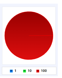

I tested in both a 9.1 platform and 9.3.4 with adding a pie chart and couldn't replicate;
9.1;
9.3.4;
I did have to make the container static to make the pie chart this "small" though. But even with it as responsive the legend stayed this size and only grew in width.
