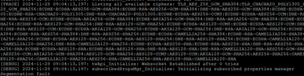

We get a “Hard fault” error.

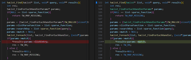

Following our tests, this problem appears to be due to memory corruption when retrieving the characteristics linked to the property in the function :
int twSubscribedPropsMgr_PushTypeFromProperty...
jasonFragment = cJSON_GetObjectItem(def->aspects, “pushType”);
following function call:
twDict_Find(tw_api->callbackList, &cbInfoQuery, &cbMatching))
To compare the operation with a different equipment (Linux), we run the example “SteamThing” on a Raspberry pi 4. Everything is OK when using the option:
#define TW_DICTIONARY_MODE TW_DICTIONARY_MAP
In file twDict.c
But when we change TW_DICTIONARY_MODE to TW_DICTIONARY_LIST, We get a “Segmentation fault” error:
Do you have any idea what could be causing this problem?
We wonder if there's a problem somewhere in the list management (list.c file).

The problem has been identified and corrected:
My solution (right or wrong?.... but it works)
Before                                                                               Now
consequently the variable "listEntry" in "struct twList_FindForEachHandlerParams"  isn't necessary
