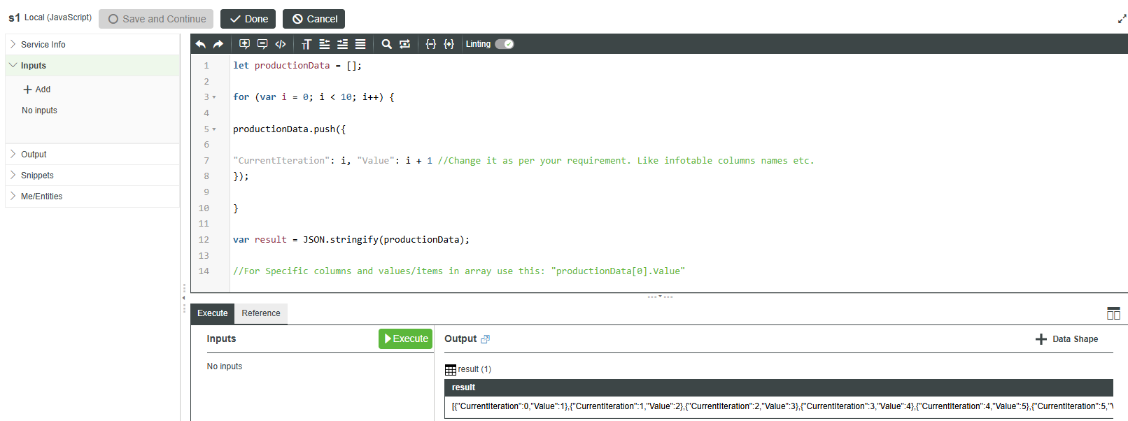

var productionData = [];
for (var i = 0; i < 10; i++) {
productionData.push({
"CurrentIteration": i,
"Value": i + 1             //Change it as per your requirement. Like infotable columns names etc.
throw JSON.stringify(productionData);
//For Specific columns and values/items in array use this: "productionData[0].Value"
1 REPLY 1
Hi Hrishabh.Sharma
I just tested your code on ThingWorx 9.6 and it worked fine.
What's the version of your Thingworx server?
Is it possible to export and share the Thing entity file(xml) here?
