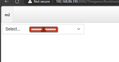

Hi everyone,
I have  a menu with 4 items (tabs).
I want to prevent  a user from seeing tab number 2.
On the menu entity, I've got visibility permissions for the user group that this user belongs to (So that they can see the entire menu). I just want this user to not see a single item in this menu.
On the group association I have added the group that this user belongs and another random group.
PS on menu item number 2, I added only the random group.
Despite all this the user can still see menu item 2.
How can I prevent this from happening?

Hi @Janicen
Instead of using Group Association, use the Groups option for each menu.
Visibility for users in MenuUserGroup
Only for user 2
/VR
Even after adding the groups by removing group associations, user2 able to see all menu items. instead of m2 menu.
Velkumar
(To:NK_10424958)
Hi @NK_10424958
Please post some screenshot
/VR
slangley
(To:Janicen)
Hi @Janicen.
Check to see if the user in question is a member of multiple groups.
Regards.
--Sharon
