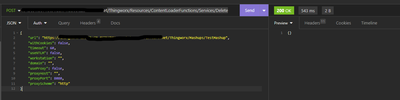

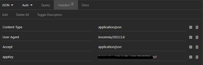

Hello @nmilleson,
When trying from Insomnia (and running the service from the composer), nothing really happens. I get a response 200 back in insomnia, but the entity still remains. Perhaps my request is wrong?
Body:
Header:
The reason why I am using the contentloader for deleting this entity is because there is no entityservice to delete mashups (and some other entity types).
If you know of any other services that can actually delete stuff like mashups, menus etc, then I'd be happy to give it a shot though!
Jens C

(you are doing a POST request in your screenshote instead of a DELETE request)
edit: ah I just noticed you call the contenloaderfunction service. so POST would be ok. But why not bypass the ContenLoaderFunction and call DELETE on
'.../Thingworx/' + entity.type + "s/" + entity.name
I think this was the idea if this even works

ContentLoaderFunction is correct. The idea of  @nmilleson was just to try if the requests already runs into the issues when called via rest api directly. Which you say is not the case. So the call itself is not the issue. Ruling out that the DELETE itself causes the issue already.

Hello @nmutter,
When trying the ContentLoaderFunction from Insomnia, I am not able to use it at all, I get a response 200 back, but it doesn't delete anything.
I tested to run it both as POST and PUT, neither worked.
I can't run it as a DELETE as then Thingworx interprets it like I am trying to delete the ContentLoaderFunction object.
What worked was running a "normal" delete on the test mashup object.
