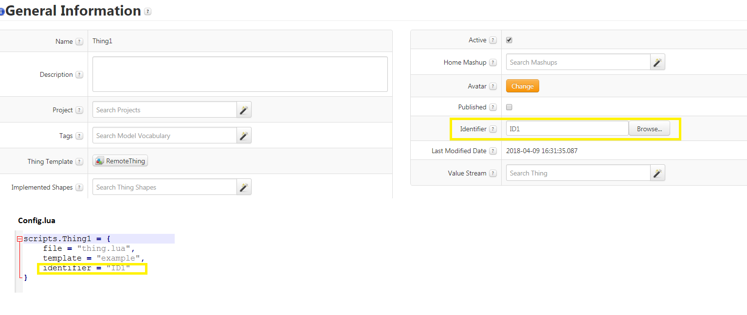

I made some quick changes to the lua file.Try with the below config.lua
scripts.log_level = "DEBUG"
scripts.PiThing = {
                file = "thing.lua",
                template = "PiTemplate",
    identifier = "PiThing",
                scanrate = 1000,
                taskrate = 30000
scripts.rap_host = "127.0.0.1"
scripts.rap_port = 8000
scripts.rap_ssl = false
scripts.rap_server_authenticate = false
scripts.script_resource_host = "127.0.0.1"
scripts.script_resource_port = 8001
scripts.script_resource_ssl = false
scripts.script_resource_authenticate = false
 Changed the scripts.rap_port to 8000 - This should be the port on which EMS is running. Should be the same as the http_server port in config.json.
I have also added the identifier in the binding section.
Let me know if this helps.

April 4, 2018
Hello Charlotte,
I noticed that you are using scripts.rap_host = 8080 instead of scripts.rap_port = 8080 in the config.lua.
Also as you have defined an identifier for the remote thing in the config.lua have you also added the identifier to the PiThing in the Composer?
