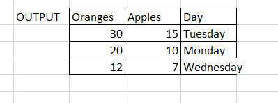

I have an Info table that stores the sales of fruit a day. See (MyTable.png)
<MyTable>
I want to add the number of fruits I sold each day then reorganize my table to that the day that has the highest sales can appear at the top of my list, and the day I on which I had the least sales should appear at the bottom of the info table. See the image below:
I've written up a piece of code, however I have hit a wall because the sum of the sales per day is not correct. How can I fix this:

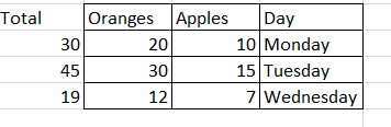

The output will look like this:
