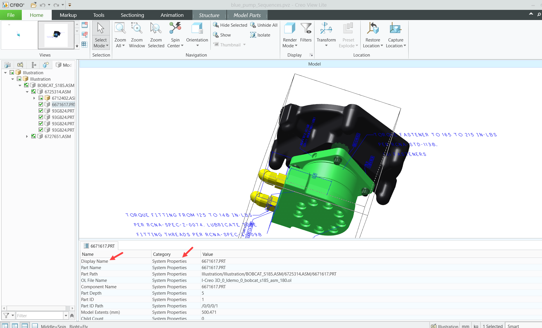

Hi @MA8731174,
Try setting SelectedPartsSelectionMode to Property value
As for SelectionPropertyName and SelectionPropertyGroupName, you can open the CAD file in Creo View to examine which attribute contains the part name data.
In my example, I want the get the value of "Display Name", so I should configure SelectionPropertyName as Display Name and SelectionPropertyGroupName as System Properties
ThingView widget in action: I select a part and I get the propValue I want in SelectedParts

Thanks but what should i write in SelectionPropertyName and SelectionPropertyGroupName  properties?
i would like to have the part name as we open the file in creo we can see in .PRT when i click on part from model then i would like to have the name

Thank you for a detailed answer. It works now. I have also configure SelectionPropertyName as Display Name and SelectionPropertyGroupName as System Properties and it worked as expected.
