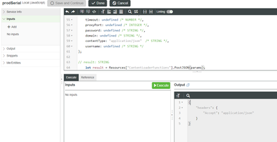

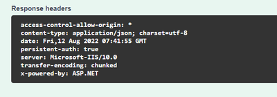

I am doing a postJson method in ThingWorx. But it is not returning the response body. When I execute the method in swagger, it is returning the response body but TW is returning just the headers. It is not returning like swagger but I wanted to read the response exactly like Swagger. How can we achieve this use case?
Swagger:

August 2, 2022
What you see in the output is not the response headers, but the request header.
1. Which ThingWorx version is exhibiting this?
2. Are you sure you're replicating the same POST request in ThingWorx? I see no password/username in the screenshot you supplied, but maybe you're passing an authorization token in the header? What about the request body, is it the same as the one you supplied via Swagger?

August 4, 2022
As VladimirRosu pointed out, missing necessary header might cause PostJson fail and return Header instead of Response.
Can you recheck the parameters?
