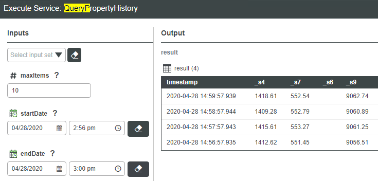

Look back size * Data sampling frequency = the total numbers will be feed to run calculation, for which I call it Look back area, the data is queried from Value Stream, with maxItems = look back size, and startDate = current date – look back area.
For example, if look back size = 4, data sampling frequency = 1 minute, then look back area = 4 minutes.
Thingworx used Value Stream to log Time Series Data, we can run service of QueryProperyHistory to get historic data:

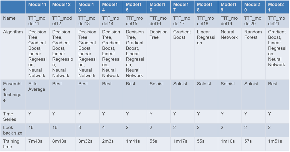

Some other notes for TTF prediction models:
  • Always set useRedundancyFilter = true
  • Always set useGoalHistory = false
  • Always set lookahead = 1
  • Training time is much longer than Non Time Series data

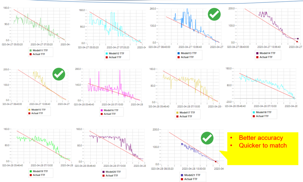

Below charts show the comparison between Time Series Data models predicted TTFs and actual TTFs.
We can see that, compare to Non Time Series models, the prediction is much more accurate, and is faster to match the actual TTF curve.
Below table lists out the settings of all models:
