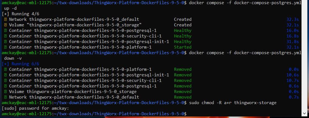

Hi all, I've been trying to get the Twx 9.5.0 dockerfiles up and running on WSL2. I've managed to build all of my images (Security CLI, platform-postgres) and get them to spin, but it looks like Thingworx can't connect to the provided 'starter postgres' database, and the Platform shuts down:
2024-05-02 21:04:35.758+0000 [L: ERROR] [O: c.t.s.ThingWorxBootstrapper] [I: ] [U: SuperUser] [S: ] [P: ] [T: main] *** CRITICAL ERROR ON STARTUP: Connections could not be acquired from the underlying database!
2024-05-02 21:04:35.758+0000 [L: ERROR] [O: c.t.s.ThingWorxBootstrapper] [I: ] [U: SuperUser] [S: ] [P: ] [T: main] *** Web Application STATE is being set to ERROR! ***
2024-05-02 21:04:35.758+0000 [L: INFO] [O: c.t.s.ThingWorxServer] [I: ] [U: SuperUser] [S: ] [P: ] [T: main] >>>>>>> PLATFORM SHUTDOWN START <<<<<<<<<
I've handled this error for non-Docker installs. But this database is ephemeral, I think I've searched myself in circles, and I'm not sure how to further debug. From what I can tell, my Compose file should be fine (below). Have I misconfigured something, forgotten to open some port on Windows, or am I missing something? Any wisdom would be appreciated.

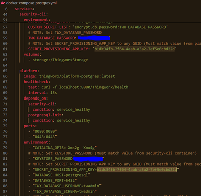

When I look at the yml file which you have included. Why is there no "volumes:" section for the postgresql section?
In my test environment I have:
In your Security-CLI you are storing inforamtion in the default location. You might want to assign that to a specific location:
You have not provided a value for "THINGWORX_INITIAL_METRICS_USER_PASSWORD" not having a value for this symbol will result in an error message.
For the field "SECRET_PROVISIONING_APP_KEY=VerySecret"  If VerySecret is redacted GUID, great. If not then you need to get a GUID value.

I run Docker under WSL2 because I wish to avoid using the Docker Desktop software product, and because it gives me a Linux-like environment. Last I tried anything 'Docker for Windows', it was a huge pain. I was able to do my Docker CLI tutorials on WSL2, so it works as a host environment.
I'm not running this as any kind of Production server, but am working to get it running in the default state before I tweak too much of it. So, in regard to data in default locations, it should be fine. When I generated this file, there was no 'Volumes' section in the Postgres service, so I didn't touch it. I don't need to save any of the data from this container, and will move to using an external DB in later steps.
I've also made some changes to my config based on your reply. Metrics user has a password set, and I updated the Secret Provisioning key (formerly, it was a non-GUID string), but I get the same issues (Critical Error On Startup, Connections could not be acquired from underlying DB). Does your own Secret App Key GUID use the same format as I show? I used https://www.guidgenerator.com/ to make something up.
And yes, I've read into the Thingworx logs. I have to chmod them every time I run the containers, but they show what I would describe as "Thingworx turns on, can't connect to the DB, and shuts down." All the other containers seem to be doing fine.

I made an explicit Bridge-type network, and connected all of the Services to it. That alone didn't help, so I re-tread my previous steps. I had no luck for the longest time, but found a temporary solution, by setting `POSTGRES_HOST_AUTH_METHOD=trust`. It's laughable for security reasons, but works for now, posted below.
Given this, does anyone have ideas on how to reconfigure with proper security? I still don't understand how the 'init' container connected, while the 'platform' was (previously) unable.
