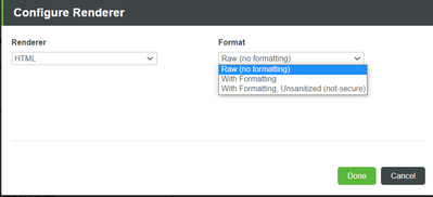

1. Instead of Web frame, use HTML widget and put the url there. See if it works or not.
2. If above doesn't work, instead of HTML or web frame widget use, value display widget and bind the data (which is URL coming from some service or property). Find "ValueFormat" property of value display widget and click renderer. You will see attached popup. Test with any of these format dropdown option. It should work.

Thanks for the replay Shayam.
I tried with HTML and value display as well with "HTML code with iframe tag", but no luck.
