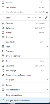

Currently application is showing up well at 1920 * 1080 .Need to make thingworx application usable at 1920 * 1200(Size of text ,apps - 100% and 150% ) but in the pc specified resolution is not available in display settings. Suggest us on how to proceed further.

our browser setup is as per below screenshots.:
There are two different zoom percentage options at inspect in screenshot 1 and the other in browser setting in screenshot 2. Kindly let us know what is difference between both and why scrolls when using inspect option.

You didn't do what I wrote. Set 1920x1200 there, then adjust the zoom (that "100%" to the right of the resolution), so that you don't see the scroll bars. Leave the "browser zoom" at 100%.
> And can you let me know difference between browser settings zoom and the zoom here.
Browser zoom is for normal browsing. Set it to what your end users will have, e.g. 100%. The "zoom here" is for testing how your UI works on devices with different screen resolutions. This helps you to test by removing the scroll bars.
