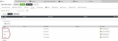

Technically speaking (and not changing the workaround suggested below), if you are speaking about ThingWorx Data Tables, they do have events for row CRUD operations:
The issue though, is that these events are server-side, perfectly usable in subscriptions, but unusable for client-side (mashups).
You can not trigger a Mashup activity (eg: service execution) based on a server-side event (even if they share the same name, "event", they happen in different places and are incompatible with each other).
