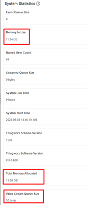

Is your system using 100% CPU or is Tomcat using 100% Memory in the JVM?
Unless you have a very low amount of memory on your server, it will be more likely to hit 100% CPU, which would probably mean that you are spawning threads faster than that ThingWorx processes them.
For example your subscriptions fire every second, but your subscriptions actually take longer than 1 second to be processed so that the next set of subscriptions fire off and start to stack up.

Not sure if you set a JVM Memory max limit, but that would show in the server memory usage.
Also you can look within ThingWorx by going to Monitoring/System Statistics
You'll also see an Event Queue there, if that is continuously going up or staying very high would indicate that your are 'overloading' the processor(s)
Hi @PaiChung ,
is this the issue ?
Shashi.
It looks like you are indeed running out of memory.
Easiest would be to increase your server memory and JVM Max memory setting.
It will require a restart.
Hi @PaiChung ,
the same configuration is been using for an year now, suddenly this issue came up from last one week, may be there is some other root cause for this ?
Shashi.
I do not know what may have caused it sorry.
