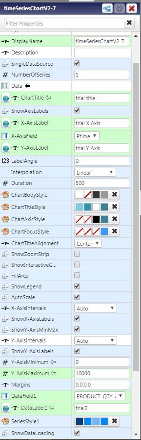

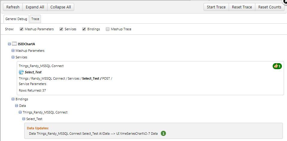

I am new to TWX and I am trying to create a simple mashup one time series chart.
At "View mashup", I am getting a blank chart, but "Debug Info" shows that I  have several rows returned.
What am I doing wrong?
Thanks in advance.
Randy

Hi @RandyGui may be this is an issue with the DataShape which is being used in the service's output. While it is correct that your service is working fine by returning x number of rows, however what should be checked here is that what DataShape is assigned to the output and what has been selected for the X & Y axis properties for the Time Series chart. See Time Series Chart Widget property details here

Hi Supandey
It seems that I made a mistake with data column name and it's alias name.
chart's working fine now.
Thanks again for your help.
Randy
Hi supandey,
I'm at work atm and blocked from Youtube. I'll take a look at the vid after work.
Infotable is assigned as output BaseType.
The datashape assigned to output has 2 fields with datetime and integer as BaseType.
Here are the property settings.
Randy
