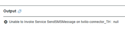

During executing Twilio thing to send message I got this error -

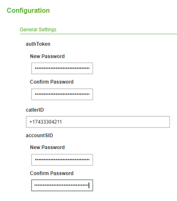

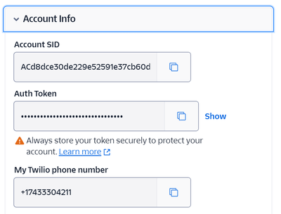

I got AUTH TOKEN, ACCOUNT SID and a TWILIO PHONE NUMBER from Twilio and same I have entered in the Thing Configuration
While trying to send test message I was not able to send it. Shows an error output

I have loaded the Twilio Extension into an Thingworx environment. When I go to configuration, I see the same box's you show in your screen capture.
Just a general question when you entered the phone number you included the "+". I would not expect that to be required.

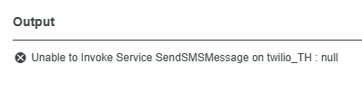

I am using a Administrator account. I have checked with the logs and I have shared the log on the previous messages.But again i am getting this output -  Unable to Invoke Service SendSMSMessage on twilio_TH : null

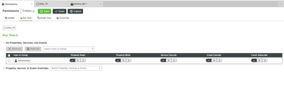

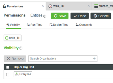

Hello @VladimirN , When you edit your THING, which uses The Base Thing Template "Twilio", What do you find when you look at the permissions tab?
There are 3 different groups of Permissions (Visibility, Run TIme, and Design Time)
If you are using an account which is in the Administrator group, you are configured to have full access. If you are in another group then you need permissions.
Let me know what you find

Hi, @PEHOWE , I am using with Administrator group.
Anyhow I am getting the same error - Unable to Invoke Service SendSMSMessage on twilio_TH : null
Abhishek_Tirkey_0-1739937028085.pngAbhishek_Tirkey_1-1739937067503.pngAbhishek_Tirkey_2-1739937086036.png

In the Configuration Tab you need to provide a "CallerID", which is a valid Phone Number.
In the screen capture you have  provided "+17433304211".  The information in what you have provided is Country code (+1) followed by a 3 digit area code (743) followed by 7 digit subscriber number (3304211).
Have you tried changing the CallerID to exclude the Country Code information?

You have confirmed that your account is an Administrator Account. While that should provide full access to the environment.
Have you added your account to the Permissions Tab (Visibility, Run Time, Design Time,  Ownership)
While I agree that this should not be necessary. The error message you provided "Unable to assign default permissions: null" makes me want to ensure that I know the permission is assigned.

I have tried changing the CallerID and other information in all possible combinations. I have also added my account to the Permissions Tab and shared screenshots in previous conversations.
