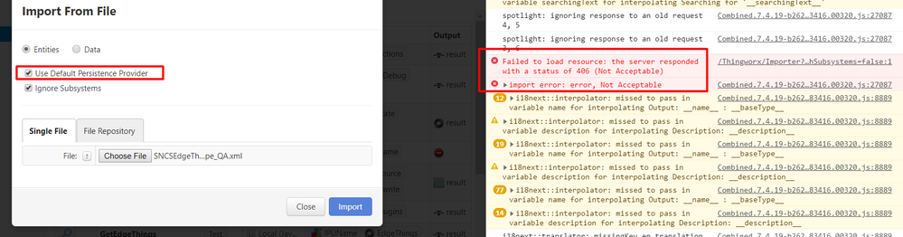

The error is 406 Not Acceptable.
2019-09-08 18:28:17.766-0500 [L: ERROR] [O: E.c.t.w.Importer] [I: ] [U: thingworxRead] [S: ] [T: http-nio-192.168.230.139-443-exec-44] [message: Import Failed: java.lang.NullPointerException] com.thingworx.contentmanagement.ImportProcessor.processImport(ImportProcessor.java:1764)
Wrapped by: com.thingworx.common.exceptions.ModelAccessException: [2,006] Unknown error occurred. Contact the administrator if this re-occurs.
The detail error in Error log is
2019-09-08 18:28:17.766-0500 [L: ERROR] [O: E.c.t.w.Importer] [I: ] [U: thingworxRead] [S: ] [T: http-nio-192.168.230.139-443-exec-44] [message: Import Failed: java.lang.NullPointerException] java.lang.NullPointerException: null

I have tried to import the attached ThingShape and it is importing without error (Important: enable Use Default Persistence Provider) in Thingworx 8.3.4 and 8.4.4 (H2).
But if Use Default Persistence Provider is not enabled, I get also "Not acceptable" error.
Also, check if you have connectivity to your database by connecting with twadmin.

htran-21
(To:raluca_edu)
Hi @raluca_edu
Yes, i also tried to enable "Use Default Persistence Provider", unfortunately it did not work either.

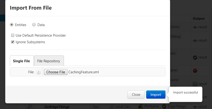

Of course, the connection is good cause that's a working system and i am using an Administrator account, I could import others well, except the one here. The TW version here is 7.4.19-b262.
Other entities, also other ThingShapes are working fine. CachingFeature is also a ThingShape XML and it works fine.
The different point is the one here is being used by thousands of entities. I assume that the system requires a long time to recompile all dependents and a timeout occurred internally. It seems to be a bug.
