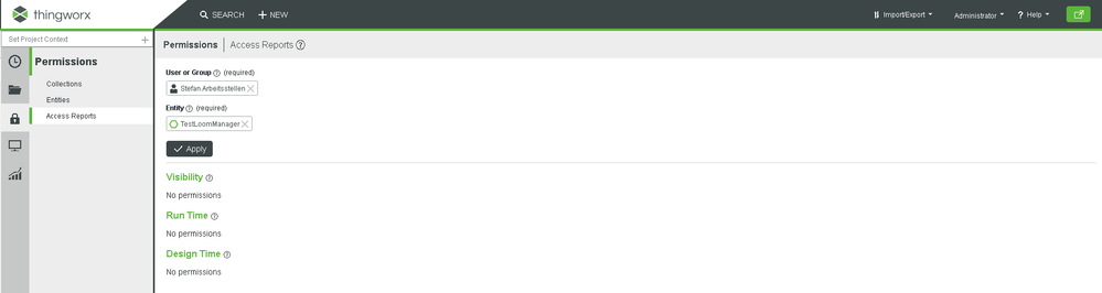

I want to remove the visibiltiy of a thing for an exsisting user. Despit removing all the visibility, run time and design time permissions the user is still able to see the thing and even edit the properties. He can't add properties or update the thing.
The user is called Stefan Arbeitsstellen
The Thing is the TestLoomManager
I used the access reports feature to check what is causing him to have this ability, but it shows nothing:

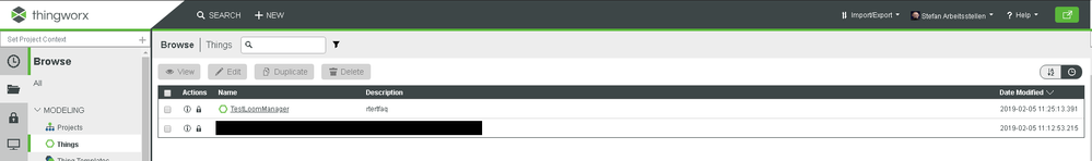

As you can see in this screenshot I'am logged in as Stefan Arbeitsstellen but I am still able to see the TestLoomManager.
I also removed all the permissions for the Templates and Shapes that are used with the TestLoomManager.
Do you have any idea whats the cause of this behaviour?

Check the permissions at the Collections level.  They will override permission settings at the thing level.

I checked permissions at the collection level. Either the user nor his group have any rights at the collection level for things and projects. (No Visibilty, Run Time and Design Time permissions)
The thing is still visible and editable for user Stefan Arbeitsstellen.
