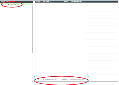

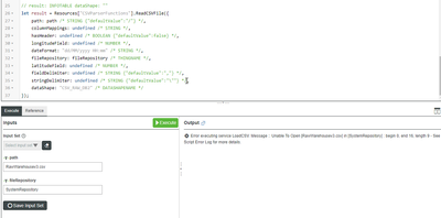

Why i can't read csv file from function ReadCSVFile
  • June 10, 2024
  • 777 views
I uploaded the file to SystemRepository. But I can't read.

Hi @TW_10599876  Can you follow the below steps and let us know your output?
  1. Create a mashup with FileUpload widget
  2. Let the user upload the CSV file to a FileRepository via the mashup
  3. On upload complete call a service in TWX using CSV Parser to read the CSV
  4. somehow transform the data for your mashup to visualize it (not clear what visualization u need)
