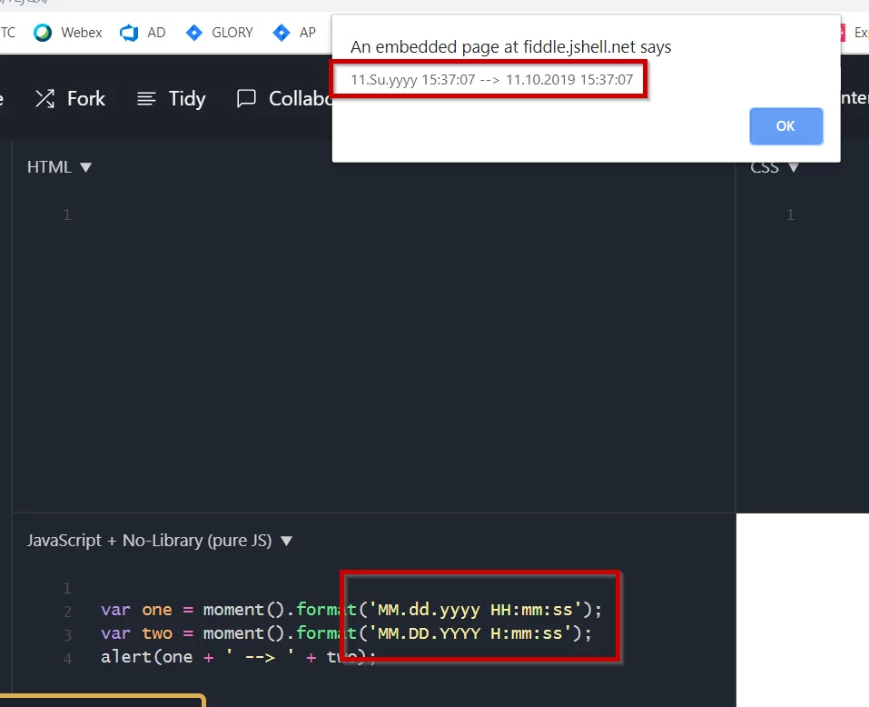

Hello @Mr_Henry_M,
Advanced Grid bundles Moment.js, which has its own unique syntax: https://momentjs.com/docs/#/displaying/
In your case correct format will be "MM.DD.YYYY H:mm:ss".
/ Constantine

Hello @Mr_Henry_M,
/ Constantine
