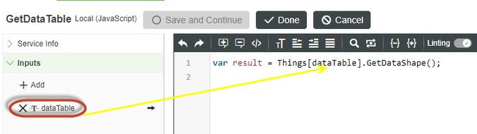

If I understand you correctly, the relationship between thing service and list widget is as below:
Am I right? If so, the displayField and valuefield will be "result", it can dynamically display the names of different datashapes used by different dataTables.
