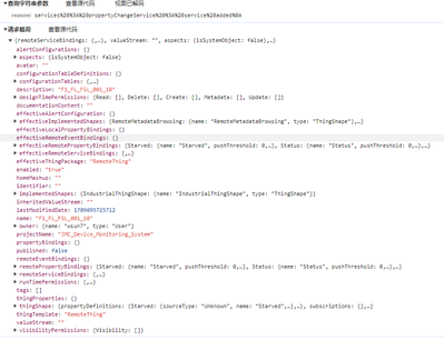

In the thingworx plantform we  add service and open developer tool we can see we have send a http request as below,in the body there are a lot of   parameters,
is  there any document show  how to add those parameter?

You can use the below endpoint to add a service definition
https://<<HOSTNAME>>/Thingworx/Things/<<THINGNAME>>/Services/AddServiceDefinition
Method: POST
Body :
  description : "Service description",
  category : "",
  parameters : INFOTABLE,
  resultType : INFOTABLE,
  remote : false,
  remoteServiceName : "",
  timeout : 1000
This will only create a service definition without any logic inside
To create logic refer this article - Solved: Create service programmatically - PTC Community

YC_10946483
6-Contributor
(To:Velkumar)
Thanks a lot!
