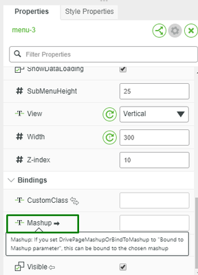

1. I have the menu in my master and I want the details of the selected menu.
2. Can I have the mashup name of a selected menu from the menu widget? If yes then how.

Suppose I have the menu in my master. The menu is like electronics, groceries, and vegetables in horizontal.
Now the question is simple. How can I get the detail of the selected menu?
If I select groceries then I want to know the details of the grocery menu like
menu .linkDestination = "MainMash";
menu .parentMenuId = "TotalCareMenu";
menu .menuId = "TotalCareMenu_0";
menu .isDefault = "true";
menu .imageURL = "";
menu .linkTarget = "Self";
menu .description = "";
menu .linkType = "Mashup";
menu .title = "[[MAP]]";
Thank you.
Hi, the menu widget has a Mashup property which we can bind to other widgets or a service. This property gives us the Mashup name selected from the Menu item. Please refer to the below screenshot.
Hope this helps.
Thank you for your concern but I'm not able to achieve what I want.
I bind this mashup(which you display in the screenshot) with my service parameter but I'm not getting anything.
I checked with the logger it is showing undefined.
I got one more way. Menu > Service > GetEffectiveMenu with All Data of this service I'm getting all menu data.
But I need only the selected row. Like the menu, the name is Menu1, Menu2 & Menu3 is written If clicked on Menu2 then I want every detail of Menu2 like mashup name, parentID, menuId, and other details.
But with this service, I'm not getting the details of selected rows.
Thank you.

HI @slangley,
Ok, I'm explaining to you.
I have a dynamic menu in which I'm loading AllData from a service. In this menu, I have 3 items or you can say 3 rows. So as you know these 3 rows will become 3 menus.
So my question is simple I want to make the first map is byDefault selected.
My codes are here.
var row = new Object();
row.isDefault = true;
row.parentMenuId = "";
row.imageURL = "";
row.description = "";
row.menuId = "Menu";
row.linkType = "Menu";
row.title = "";
result.AddRow(row);
row = new Object();
row.linkDestination = mainMash;
row.parentMenuId = "Menu";
row.menuId = "Menu_0";
row.isDefault = true; // I make it true by after that also it's not working.
row.imageURL = "";
row.linkTarget = "Self";
row.linkType = "Mashup";
row.title = "[[MAP]]";
result.AddRow(row);
row = new Object();
row.linkDestination = "ReportsMash";
row.menuId = "Menu_1";
row.isDefault = false;
row.imageURL = "";
row.title = "[[REPORTS]]";
result.AddRow(row);
row = new Object();
row.linkDestination = "SettingsMash";
row.menuId = "Menu_2";
row.imageURL = "";
row.title = "[[SETTINGS]]";
result.AddRow(row);
now please tell me how to make default selected.
