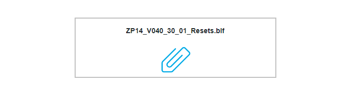

I have uploaded a blf file in Repositry but when i click on it i download it as file with name fileRepositryDownlader.
My QUESTION
1) When i download a file. It needs to be the same file blf type file which i have uploaded it. (My major requirement is that i want to download it from mashup.)
2) When i click on file in mashup it needs to show me the file content same as we open PDF in mashup.
ABOVE file looks when i download it
below you can see in mashup it shows like that.I have uploaded it manually in fileRepositry.

I am using webframe widget in mashup. It works fine for PDF and it view it in browser and then i can also download it but for this blf type i just want to download the file but its not able to download it. If i ZIP the file and download it then ZIP is able to download easily. do you have any solution?

I am passing parameters from main mashup in collections  with service GetFilelistingWithLinks of repositry and send to webframe.
For me when i click on the media then it opens in webframe and also downloads the fil. It shows me like that.
what do you think can be the issue?
