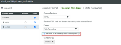

In latest version of ThingWorx you can configure the column and set this property that would to the trick:
If you don't have this option in your current version, you may need to introduce a new column without any link (just the value) and trick the system to sort on this one. But this solution depends if you are sorting on server side or on client side.
