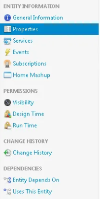

It might be because that the "LinePartTemplate" is not implemented by atleast one thing.
Check if "var partList = ThingTemplates["LinePartTemplate"].GetImplementingThingsWithData();" is returning any result table.
If not then create a thing with the "LinePartTemplate" and try again. Then it should return the expected result table with the implemented things.
Another easy way to check this by viewing the "Uses This Entity" under the entity information of the Thing Template
