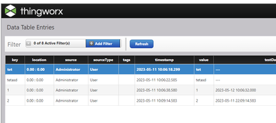

There is datetime field in datashape for storing dates in datatable. In datatable the datetime should be stored in 12 hours format without converting the datetime to string. How to do this ?

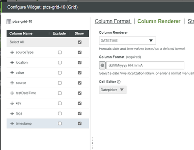

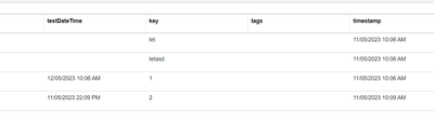

I think it is not possible to store DateTime value in 12 hours format but while displaying you can convert it to 12 hours format and display it
Something like this
Actual value stored in DataTable
You need to specify DateTime format in Grid Column Renderer configuration (if you are going to display in Grid)

Hi @AP_10343008
Something like this
