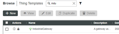

Hi:
     I was look into the Thingworx edge java SDK , it mention , the client can set a type of SDK gateway ; but in the Composer I will see Industrial gateway template ,which be use to connect a Kepware server .
     Are they the same concept ? or the Industrial gateway was a subclass of SDK gateway ; then is it possible to implement a custom Industrial gateway directly? thanks a lot
2 REPLIES 2
@XC_10035215
SDKGateway and IndustrialGateway templates both are different, the former is a template for a thing that represents an SDK functioning as a gateway and the latter is a gateway used for Industrial Connectivity Servers like Kepware. Both the templates are provided OOTB,
