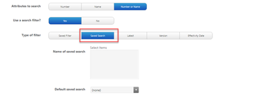

I would create a global Saved Search (named END_ITEM_SEARCH) in Windchill with attribute "End Item" = YES in bottom part of Search panel. keep keyword empty it will use as input parameter for your search.
If end item is not available see https://www.ptc.com/en/support/article/cs231904
Afterwards in Navigate go in "Edit and Collection" and select "Saved Search" :

Hi @schauvelin ,
Thank you for your answer.
It works!
