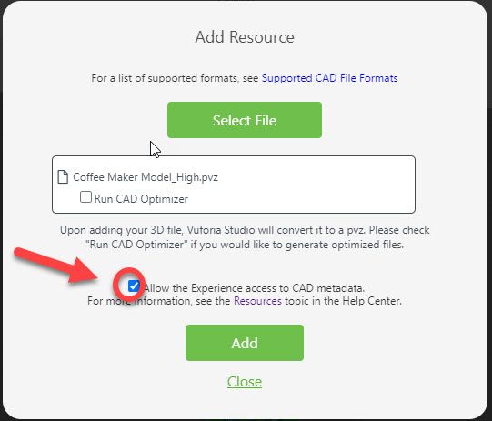

In Vuforia Studio version 8.5.13 a new metadata is intruduced. This will make the techniques described e.g. in the posts "How to extract the components with properties from a pvz file","Extracting the viewables and the seqnece steps information from a .pvz file for the usage in TWX" and "How to extract model data of 3d models in Vuforia Studio (without external Tools)?"  for the most cases not neccessarly any more. as In Vuforia Studio when a model is imported (add Resource) there is a new check button “Allow the Experience access to CAD metadata” :

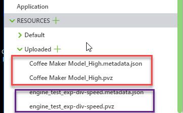

The selection of this checkbox lead that when the model is loaded to the “app/resources/Uploaded” folder but also an a json object with the name <model name>.metadata.json
Example when we load the model “Coffee Maker Model_High.pvz” then we have also a json file named “Coffee Maker Model_High.metadata.json”. This JSON file contains the metadata to the coffee maker model

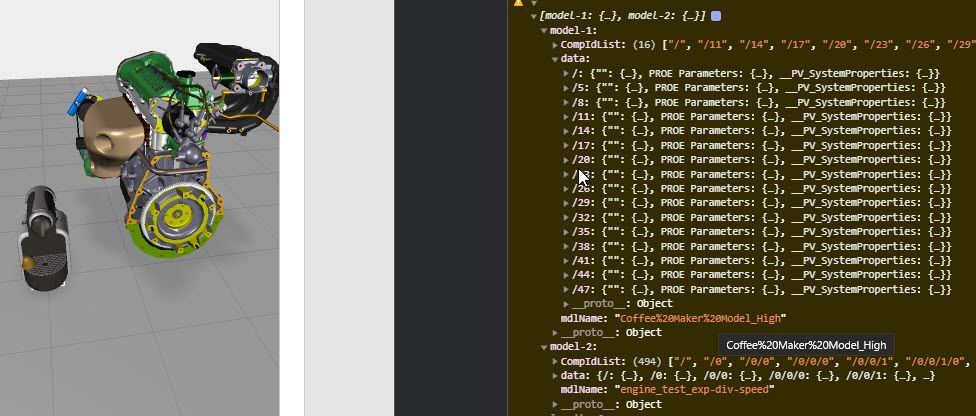

 The code listed above will load the json file to the modelWidget/s (it will works also if we have many model widngets there - and each model widget ponts to model which is imported with metadata)
When we  test this code we can check the object in memory (console.warn() ) :
Now we can access the metadata using the normal JSON functionality - so we can   access the component data via the Comp Path Id / id paths - corresponds to the modelItem widget property occurrence:

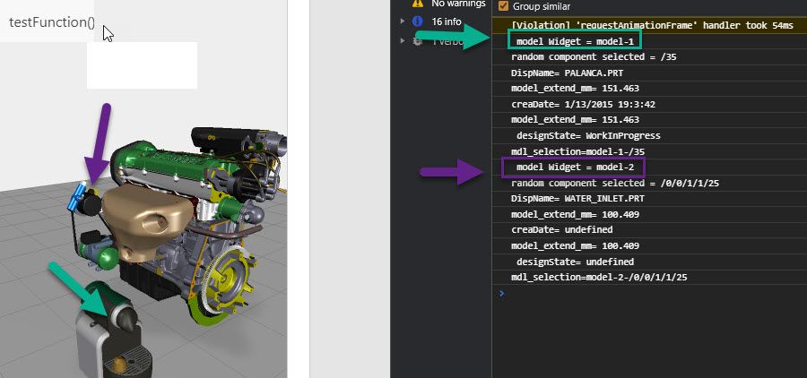

$scope.app.testFunction= function() {
 // visiting array with string index
 Object.keys(metaDataArray).forEach(function(key){
 console.log(" model Widget = "+ key);
 let compList = metaDataArray[key]['CompIdList'];
 //select randomly from the coponent list
 let randomNum= parseInt(Math.random()*metaDataArray[key]['CompIdList'].length)
 let randomComp= metaDataArray[key]['CompIdList'][randomNum];
 console.log("random component selected = " +randomComp);
 // let DispName = metadata.get(randomComp, 'Display Name')
 /*** you can use here one of the following fields
 "Child Count","Component Name","Display Name","Model Extents (mm)","OL File Name","Part Depth""Part ID","Part ID Path","Part Name","Part Path"
 let DispName = metaDataArray[key]['data'][randomComp]['__PV_SystemProperties']['Display Name']
 console.log("DispName= "+ DispName)
 let model_extend_mm = metaDataArray[key]['data'][randomComp]['__PV_SystemProperties']['Model Extents (mm)']
 console.log("model_extend_mm= "+ model_extend_mm)
 let creaDate = metaDataArray[key]['data'][randomComp]['PROE Parameters']['CREATION_DATE']
 console.log("creaDate= "+ creaDate)
 let designState = metaDataArray[key]['data'][randomComp]['PROE Parameters']['DESIGN_STATE']
 console.log(" designState= "+ designState)
 // make a selection string for this component
 let mdl_selection= key+"-"+randomComp;
 console.log ("mdl_selection="+mdl_selection)
 // generate some random rgbá color
 let r =parseInt(Math.random()*255);
 let g =parseInt(Math.random()*255);
 let b =parseInt(Math.random()*255);
 let a =parseInt(Math.random()*0.8)+0.2;
 //apply blink funciton for this component selection with random color
 $scope.blinkSelection(mdl_selection,'rgba('+r+','+g+','+b+','+a+')',200,22);
When we test the listed code above we will have in the chrome console window:

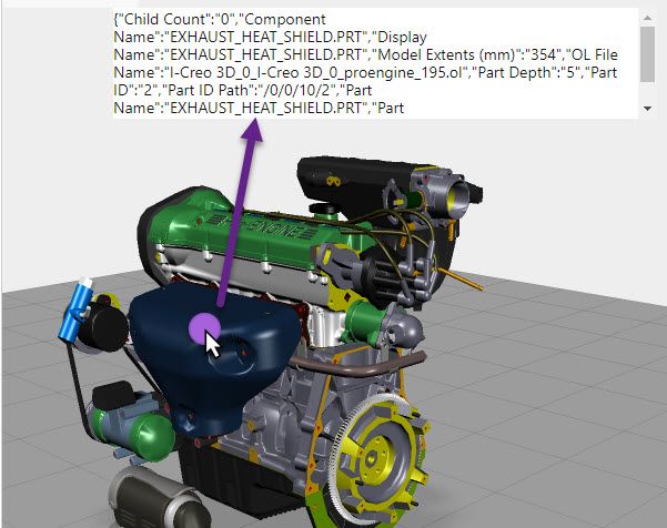

Using furhter the json  functionality we can also implement e.g. some user picks where you can associate it with the metadata :
angular.forEach($element.find('twx-dt-model'), function(value, key) {
 // find all model widget feature and perform funciton()
 // for each model widget - key == modelWidgetId
//define the userpick function for each modelWidgetId
angular.element(value).scope().$on('userpick',function(event,target,parent,edata) {
if (edata) {
 if ($scope.currentSelection) { // selection is not null make it undefined
 tml3dRenderer.setColor($scope.currentSelection, undefined); }
 //create the selection string <modelWidgetId>-<occurance Path Id>
 $scope.currentSelection = target + '-' + JSON.parse(edata).occurrence;
 //generate a random rgba color
 	//call blinkSelection function for the selected component
 $scope.blinkSelection($scope.currentSelection,'rgba('+r+','+g+','+b+','+a+')',200,10);
 //write the data SystemProperty of this compoonent in to a textArea Widget
 $scope.setWidgetProp('textArea-1','text',JSON.stringify( metaDataArray[target]['data'][JSON.parse(edata).occurrence]['__PV_SystemProperties']));
This code will write the meta data to the selected component form the __PV_SystemPoperties section to a text area widget. Also the component will blink fwith random rgba color:

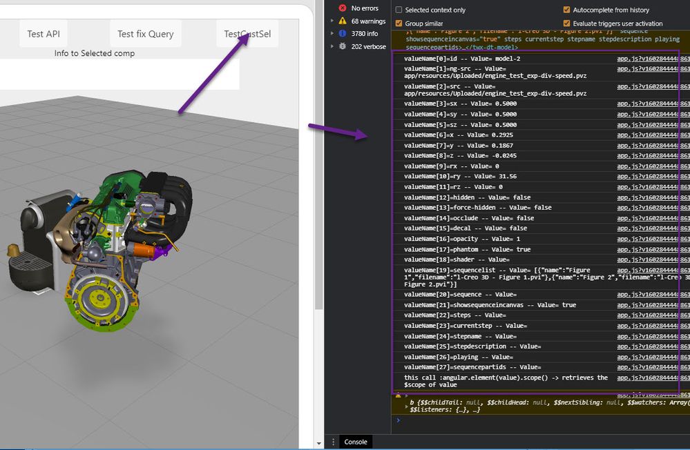

  2. To call for the selected object a callback function where the Path id was passed as function argument:
$scope.app.testCustomSel= function(){
let pathDepth=4
$scope.app.testCustomSelection('model-2',
 $scope.app.whereFunc,$scope.app.selectFunc,pathDepth)
 $scope.app.testFind1_modelId='model-1'
 PTC.Metadata.fromId( $scope.app.testFind1_modelId)
 .then(function(meta)
 {meta.find('Part Depth').lessThan(3).find('Display Name')
 .like('PRT',$scope.app.selectFunc);})
//========================== app.testCustomSelection
$scope.app.testCustomSelection= function(modelId,whereFunc,selectFunc,pathDepth) {
 BPRN("app.testCustomSelection()");
 $scope.app.testCustomSelection.modelId=modelId;
 $scope.app.testCustomSelection.pathDepth=pathDepth
 var metaDATA= PTC.Metadata.fromId(modelId)
 .then(function(meta) {meta.findCustom(whereFunc,selectFunc);})
$scope.app.whereFunc = function(idpath) {
 // scope var `this` is the metadata instance
 const depth = this.get(idpath, 'Part Depth')
 const name = this.get(idpath, 'Display Name')
 return parseFloat(depth) > $scope.app.testCustomSelection.pathDepth ||
 (name && name.search('PRT') >= 0)
$scope.app.selectFunc = function(idpath) {
 console.log("app.selectFunc["+$scope.app.testCustomSelection.modelId+"] idpath="
 +idpath+ " >>>Name: "+name);
 return this.get(idpath, 'Display Name');}
In the example above the query is done by the  where function and for all selected models the callback function select Func  is called where the pathId was passed to the function
