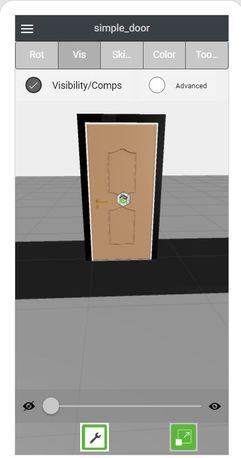

1.) uploading different models -  so we can use an additional models for each cut and then we can change the model if you want to display a cut, it means you can make the one model not visible and the display the second model or vice versa.  I tested with cuts created in Creo Illustrate 5.0 and Creo View 5.0 but it seems that Vuforia Studio could not display them /neither as part of sequence or as static to the current figure:
The only possible  way in this example is to create in Creo an assembly cut /with option cut also on part level  and  then create from there a new .pvz model.
In this case this seems to work fine:

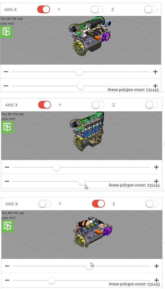

The last most powerful option is to use a shader for the model Widget. So for example we can use some kind of clipping functionality of the model where we can set the x min and x max value or ymin and ymax or zmin and zmax value what should be displayed. This will create a clipping effect. So only the geometry which satisfy this criteria will be displayed.
How to achieve a clipping functionality using a shader.
3.1) define a shader - this requires creating a tmlText widget where we can define the shader Code. The code should be inserted into the text property of the tml widget
For the clipping along x axis with planes which are parallel to the  YZ plain we need to define the following javascript with GLSL:

To set the clipping values for different axes and to control it by   sliders we can use some code like this:
$scope.DIR="y";
$scope.slice = function() {
 var slicexCur = ($scope.view.wdg['slider-1']['value']/100.0)-0.5;
 var slicewidthCur = ($scope.view.wdg['slider-2']['value']/100.0);
 $scope.view.wdg['modelx']['shader'] = "slice_world_based_"+$scope.DIR+";slicex f "+ slicexCur + ";slicewidth f " + slicewidthCur;

Here the slice() function is called in the slider change event (for the both slider widgets).
For better understanding of the functionality you can review the attached Vuforia Studio project

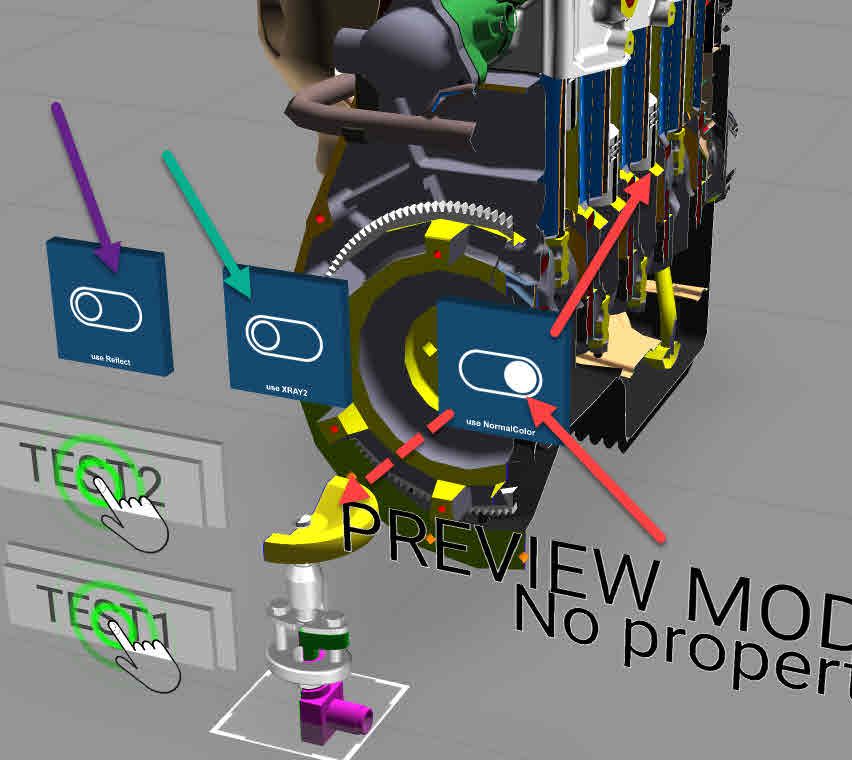

Nov 3, 2021 3:00 PM UTC
Hi all,
I want to share here a sample project which demonstrates the clipping shaders also working for HoloLens devices. Here want to remember that for mobile and preview we need to use glsl and for HoloLens devices  HLGL – which means that we need 2 different shader implementations.
Here I attached my version of the shader as project , tested in Preview and HoloLens. It contains 2 shaders /version for gl and for hl. Depending on preview mode check I will set the gl or hl shader. I have 3 slicer / cat shaders which are based on normal shader, oh xref2 and on reflect shader. There in the studio project are toggle buttons to switch between the different shaders on sample model
So the shader implementation covers only the shader type used in the community post
The shaders will clip x,y,z with length deltaxyz. I think I will follow also one  suggestion   and could implement it with plane definition (normal Vector  A B C and ( D= (x0*A+y0*B+z0*C) I do not think that this is a problem  and will provide it soon
