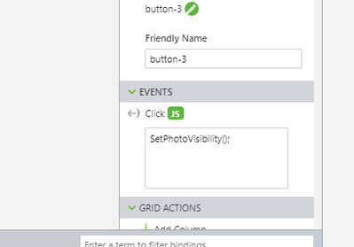

Ask for help with java script.
When I click on the 2D button, how do I write a script that makes the 3D image visible and blinks?
Please. Thank you.

Hello. Is this the behaviour you want?
In case this is it, then you need to do the following. Write a function which sets the visibility of the 3dimage and then call it whenever the 2d button is clicked. In the example above, I wrote the following function in the Home.js
$scope.SetPhotoVisibility = function(mode)
  $scope.app.view.Home.wdg["3DImage-1"].visible = !$scope.app.view.Home.wdg["3DImage-1"].visible;
It reverses the visibility of the 3D Image.
Then I set my 2d button to call the function when it is clicked.
You can modify the code to add any kind of behaviour.
