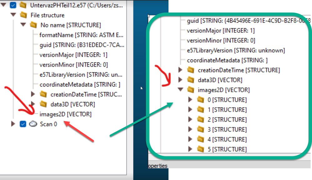

i have a scan from a plant and want to use it as an area target. my file is in the format *.e57. and im using the version 10.15.3 from the ATG
after a few seconds i get this error message:

 [   FAIL  ] 'nor:normalX', 'nor:normalY', 'nor:normalZ' fields in PointRecord structure shall be defined or we need to be able to estimate the normals. To estimate normals each Data3D structure shall have associated images from exactly one scanning position through Image2D associatedData3DGuid field.
 [ SUCCESS ] 'isColorInvalid' field in PointRecord structure must not be defined.
 [   FAIL  ] E57 shall contain one or more Image2D structures that have either 'sphericalRepresentation' field or 'pinholeRepresentation' field.
 [ SUCCESS ] 'pose' field in Image2D structure shall be defined.
 [ SUCCESS ] Spherical images shall have minimal resolution of 4096x2048 and their width = 2 * height.
 [ SUCCESS ] Pinhole images shall have minimal resolution of 1024x1024.
 [   FAIL  ] 'indexBounds' field in Data 3D shall be defined to allow for creation of an authoring mesh when each Data3D structure has associated images from exactly one scanning position through Image2D associatedData3DGuid field.

I have the same problem. When I try to import E57 data into the Area Target Generator, it ends up with the exact same error. I would also like to know where the error is. I am also using ATG version 10.15.3.

On this particular one: they simply exported the scan in a wrong way from the Leica Cyclone REGISTER 360 tool, hence the error. Partially, because our instructions on the Area Targets from Leica Scans | Vuforia Library  are somewhat outdated.
Just this week we do have a running investigation with the latest REGISTER 360 Plus - v 2023.2 to fix these instructions.
there a meant instructions on the
The issue with the particular E57 export is, that it does NOT contain panoramic image data - which is necessary. Compare (left their file, right a correct looking E57 structure):
