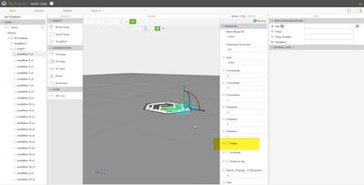

I want to decrease the opacity of a model item by half on clicking a toggle button. I am attaching screenshots of my approach to doing it.
I am unable to do it.
Kindly tell me where I am going wrong.
you can use this script to change the opacity of your model.
$scope.opp=function(val) {
switch(val) {
case 1:
$scope.view.wdg['model-1'].opacity= 0;
break;
case 2:
$scope.view.wdg['model-1'].opacity= 1;
break;
you can call
opp(1); into key pressend of toggle button
and
opp(0); into key unpressed of toggle button.
bye
Giuseppe

Worked like a charm!!
Thankxx Giuseppe
