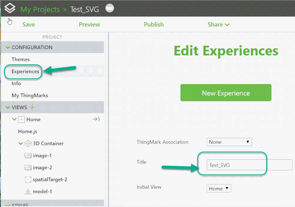

Copying an existing experience and giving it a new name does not change the name in the json metadata, so when you view both the duplicate and the original in the experience server, they have the same name. This leads to confusion of course.

Hi @Wes_Tomer ,
I think (did not test it) that to have different names you need before step 4.) to change the title of the duplicate experience:
and then step 4.)
