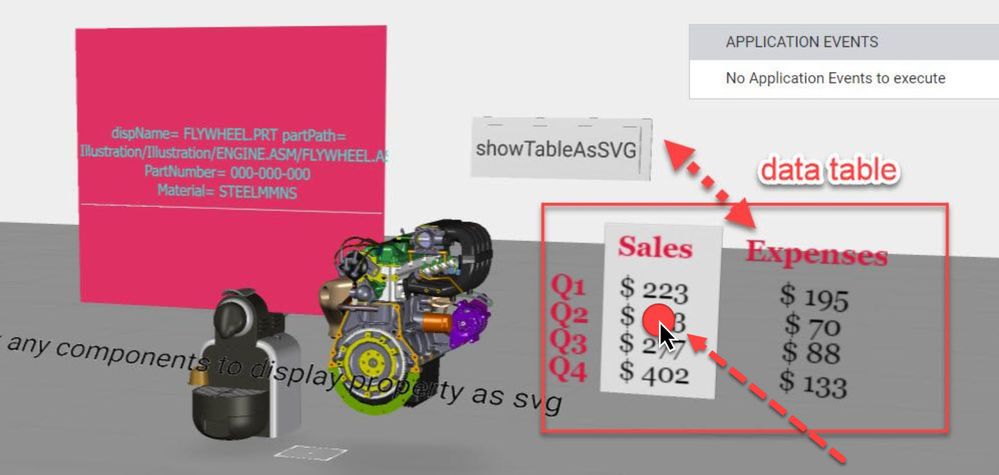

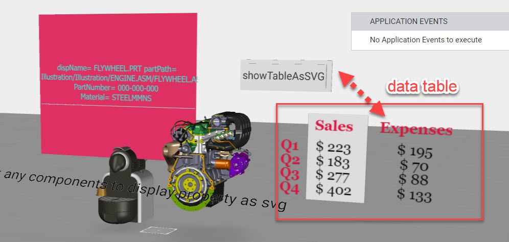

1.) use tmlText widget to define a shader and then  to display the data as shader on image panel. The data need to be passed to the shader as shaders parameter something like this  https://stackoverflow.com/questions/8847899/how-to-draw-text-using-only-opengl-methods for GLSL  ... But ! ... we need for HoloLens2 to use HLSL and I could not find a relevant example ... I did not search very detailed because I think the point 2 is that I prefer as option
2.) use the data to generate a dynamic table in SVG format and display it on e.g. Image widget. E.g. the following table from stack overflow... forum I used as example : https://stackoverflow.com/questions/6987005/create-a-table-in-svg
$scope.sampleSVG1 = function(text) { console.log("$scope.sampleSVG1")
  // Name of image widget to edit
  let sampleImgWidget = '3DImage-2';
  let svgData = `<?xml version='1.0' standalone='no'?>
<!DOCTYPE svg PUBLIC '-//W3C//DTD SVG 1.1//EN'
  'http://www.w3.org/Graphics/SVG/1.1/DTD/svg11.dtd'>
<svg width='80%' height='80%' xmlns='http://www.w3.org/2000/svg' xmlns:xlink='http://www.w3.org/1999/xlink'>
   <title>SVG Table</title>
   <g id='columnGroup'>
      <rect x='65' y='10' width='75' height='110' fill='gainsboro'/>
      <rect x='265' y='10' width='75' height='110' fill='gainsboro'/>
      <text x='30' y='30' font-size='18px' font-weight='bold' fill='crimson'>
         <tspan x='30' dy='1.5em'>Q1</tspan>
         <tspan x='30' dy='1em'>Q2</tspan>
         <tspan x='30' dy='1em'>Q3</tspan>
         <tspan x='30' dy='1em'>Q4</tspan>
      </text>
      <text x='100' y='30' font-size='18px' text-anchor='middle'>
         <tspan x='100' font-weight='bold' fill='crimson'>Sales</tspan>
         <tspan x='100' dy='1.5em'>$ 223</tspan>
         <tspan x='100' dy='1em'>$ 183</tspan>
         <tspan x='100' dy='1em'>$ 277</tspan>
         <tspan x='100' dy='1em'>$ 402</tspan>
      </text>
      <text x='200' y='30' font-size='18px' text-anchor='middle'>
         <tspan x='200' font-weight='bold' fill='crimson'>Expenses</tspan>
         <tspan x='200' dy='1.5em'>$ 195</tspan>
         <tspan x='200' dy='1em'>$ 70</tspan>
         <tspan x='200' dy='1em'>$ 88</tspan>
         <tspan x='200' dy='1em'>$ 133</tspan>
      </text>
      <text x='300' y='30' font-size='18px' text-anchor='middle'>
         <tspan x='300' font-weight='bold' fill='crimson'>Net</tspan>
         <tspan x='300' dy='1.5em'>$ 28</tspan>
         <tspan x='300' dy='1em'>$ 113</tspan>
         <tspan x='300' dy='1em'>$ 189</tspan>
         <tspan x='300' dy='1em'>$ 269</tspan>
      </text>
   </g>
</svg>`;
  let svgURL = "data&colon;image/svg+xml;base64," + btoa(svgData);
  $scope.setWidgetProp(sampleImgWidget,'src',svgURL)
Here I consider it as static table but you can of course generate it dynamical using the data sets. So the mentioned code example in preview:
I attached the test project , possibly could be helpful for you. Thanks

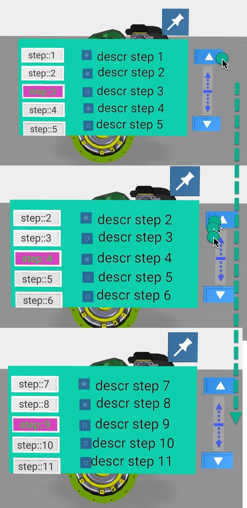

Hi @aletenti ,
unfortunately I did not have idea how to do this with  the image widget (SVG) - because , I do not know how to interpret the click with the 3D coordinates on the 3DImage. So if somebody know how to do this, so in this case this could work and we can check  in which ratio the click was on the 3DWidget - in this case we can interpret the click and find out which row/column was indented  to be selected by the click. I believe that this should be possible but have no idea how to do this.
What I did in similar case - I did have a panel with specific number of widgets as rows and columns which I used to display a list of sequences (12 where I have a list of 5 rows) and tried to use some fake  "scroll" where I change already existing element depending what they should display. So possibly this approach could be a solution but it requires  more intensive program coding:
I attached a test project. there is watch construct which is looking for  app parameter "CurrentStep" and when there is an change it will change the display of the list accordingly. It check the step number and will calculate dynamically the widget display
$scope.$watch('app.params.CurrentStep', (step)=>{
  let tS=step
  let numberOfSteps=$scope.app.NumbersOfSteps
  if(step <=2) return;
 else if(step >= numberOfSteps-1) return;
   else{
        $scope.app.prevStep2=tS-2
       $scope.app.prevStep=tS-1
      $scope.app.nextStep=tS+1
      $scope.app.nextStep2=tS+2
  console.warn("changed::")
    console.log("$scope.app.params.CurrentStep="+$scope.app.params.CurrentStep)
console.log("$scope.app.prevStep="+$scope.app.prevStep)
console.log("$scope.app.nextStep="+$scope.app.nextStep)
console.log(" $scope.app.NumbersOfSteps="+ $scope.app.NumbersOfSteps)
  $scope.app.updateProps($scope.app.prevStep,$scope.app.params.CurrentStep,$scope.app.nextStep, $scope.myFile)
In your case you can watch for another parameter where for example a TWX service will write there  a json list
When there is a change you need to set the widgets names - and also the action what the widget will do according to the list content. Such solution could be implemented  , no problem, but  I think  it will require significant more programming

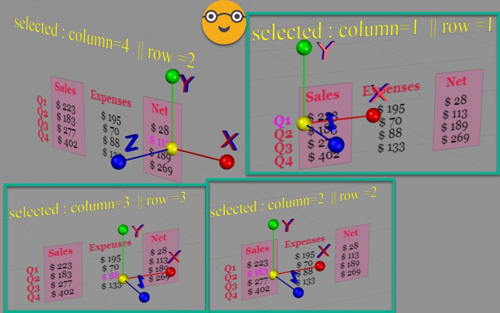

Dynamically creating 3d buttons can be done a couple of different ways, the way that has the best performance won't work with the ootb menu panels.  The way that works with the ootb menu panels is very slow when the buttons are being created and will cause your experience to pause and blink as it re-renders the holograms during the creation of the buttons.
If you just want to change what is displayed on the button, you don't need tml or a shader.  You can use the standard html5 canvas capabilities to draw whatever you want and apply the canvas to the button.  This is how the 3d graphics (3d buttons, 3d images, 3d gauges) are done ootb.
the question here  is , when I understand correctly the request , then  when we  click on a 3D element like this:
it is not how to identify which  widget we did click as element , let say 3D Widget Image (we can get this easely by the userpick event) but what is required is  the information what we clicked. As here shown in the picture - the click  means selected is the second row and second column selected. And possibly we want to have the value used there. At least, I think, this was the original question in the topic -> required some functionality    like a repeat element in 3D space. So the picture will show that to display a list is no an issue e.g. as SVG in Image but possibly as it was mentioned in the last post  here as html.
The question what I see,  is how to handle the selection - to find what was selected on the canvas.
The only idea I have is to use in 3D Space the eye vector of the device
tml3dRenderer.setupTrackingEventsCommand (function(target,eyepos,eyedir,eyeup) {
 // handle here the eyepos and calculate the intersection point with the plane
// of the panel, use x,y,z, rx, ry,rz to calcualte the plane eq.
and then to calculate the point where the eyevector will intersect the plane of the 3dWidget , let say 3DImage. Then  we will have a 3D point in space which we could interpret as ratio  in relation to the position and  the size of the 3Dimage (we need to know how many items , rows or column are displayed there) and so possibly we will then have idea what we did select.
I hope  somebody  has better idea. Thanks

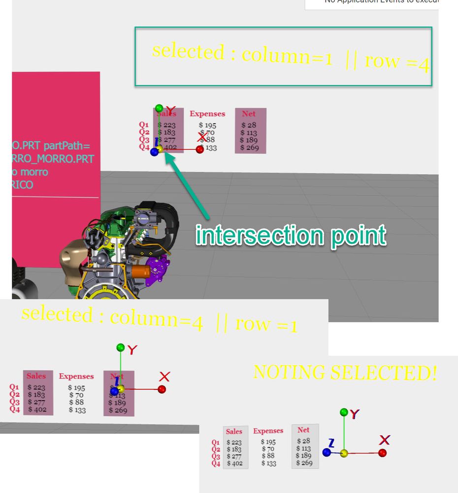

I wasn't sure if the idea what I mentioned in my last post would work. That's why I was curious to test it. I tested it and it was working. I didn't want to invest so much time in it, so the calculation is not really precise, but I wanted to test the principle - and it seem to works. It's not very performant but it works fluidly on the HOloLens 2 device with the current Vuforia View version - so that it was no issue with the display , no performance concern. OK such workflow should not be active the whole time because it did consider every tracking event and will perform some no trivial calculations.Therefore should be activated only temporary when a selection is required. So here in preview the test but I tested on HL and the resutls are  better then in preview mode:
The calculation is a vector calculation  with moderate compexity:
//  eq
//    calculate  tranform of the widget from x,y,z,rx,ry,rz calling     $scope.euler2trfMatR
//calculate then the inverse matrix
//    calculate from tranform then the vectors plane_X_Vec and plane_Y_Vec
// planeX_Vec = inversMat * [1,0,0]T
// planeY_Vec = inversMat * [0,1,0]T
//     Norm_plane = norm(plane_X_vec X plane_Y_vec)     here is X for VectorProduct von X and Y plane
//     d=(p-p0)*n/(l*n)  //according Wiki
// in javascript looks like this below
//     let dist=     dot_product( ( new Vector(planeX) ).minus(DEVICE_Location).retArray(),Norm_plane)/dot_product( eyeVecNorm,Norm_plane)
point_intersect =  (norm(EYE_VEC)*dist +DEVICE_LOCATION)
so I used as "cursor" a model which I set to the position of the intersection point with the plane where the Image is located.
This all was embeded in the $scope.app.IntersectionEYEvectorTo3DWidget callback. so in the example:
 var arrArg=[]
 let propList=['x','y','z','rx','ry','rz']
// let argStr=""
 propList.forEach((si)=>{ arrArg.push($scope.view.wdg[widgetId][si]);})
// evalStr= "arrArg.push($scope.view.wdg['"+widgetId+"']."+si+");" ;    eval(evalStr) })
let transfMat 		  =		euler2trfMatRarr(arrArg);
let transfMatInv	=	  matrix_invert(transfMat)
    let X_plane   =    new Vector( [1.0,0.0,0.0]).norm()
    let Y_plane   =    new Vector( [0.0,1.0,0.0]).norm()
    let N_plane   =    X_plane.prod(Y_plane).norm()
    let dist           =    X_plane.minus(new Vector(locVec)).dot(N_plane) / (new Vector(eyeVec)).norm().dot(N_plane)
    console.warn("dist="+dist)
   let vec_intersect =    (( (new Vector( eyeVec)).norm().scale(dist) ).add( new Vector(locVec) ))
   $scope.app.pointInts=vec_intersect.retArray()
   let point_intersect_projection=    vec_intersect.matTr( transfMatInv).retArray();
   console.warn(" point_intersect_projection==> ", point_intersect_projection)
   $scope.app.pointIntsProj=point_intersect_projection
   let count=0
   let val=0
   propList.forEach((el)=>{
        if( el.indexOf("r") == -1)    val =vec_intersect.retArray()[count];    //  x,y,z
   		else                                   val = $scope.view.wdg[widgetId][el];    //rotaiton rx,ry,rz
    	 $scope.setWidgetProp("csys",el,val) ;  count++;
  $scope.$applyAsync();
and then the projection of the intersction point x,y is used for  rundementery/not exact decsion abou the selected row column - something like this:

so that the effect /not very accurate but for the validation test is OK/ that the row/column is displayed in magenta - when there is e.g. double tap then the e.g. specific action is done for row-X column-Y
For those who are interested in how this programme code works, here is the 3D eyewear project to try out (in preview and on Hololens 2 ). It is just a test which is not optimally programmed, only as a case study of what is possible.
The most of the math function are loaded with the javascript file "app/resources/Uploaded/MyMathFunc.js" e.g. the class Vector
