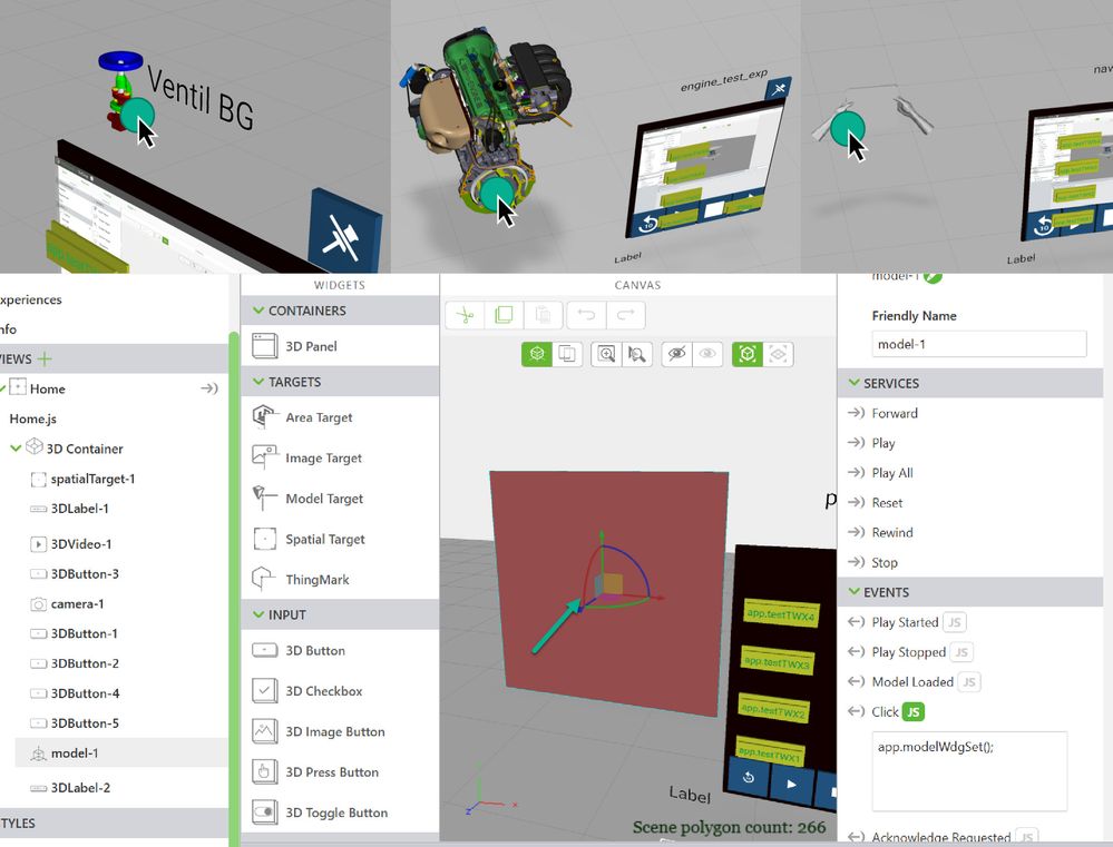

Now I tested with pvz file . And that works also fine. So means using a TWX downloadLink will work. That approach is much easy to hanlde and it makes the usage of the loadBinary unnecessary . If you want to know when the method is completed you can use for PVZ e.g. the event of the modelWidget $rootScope.$on("modelLoaded",function() {....}) So tested with a Repository list and the loading of the pvz models was working fine. /on HL and mobile
and used some code like thatbelow. So when clicked on the 3D Widget it change the model with the next model of the json list.

angular.element(document).ready(function() {
$scope.populateModelList();
$scope.app.numberArr=JSON.parse(JSON.stringify($scope.app.params.myList)).length
$scope.app.countArr=0
$scope.app.modelWdgSet= function () {
$scope.view.wdg['model-1']['src']= JSON.parse(JSON.stringify(($scope.app.params.myList)))[$scope.app.countArr].value;
$scope.view.wdg['3DLabel-2']['text']= JSON.parse(JSON.stringify(($scope.app.params.myList)))[$scope.app.countArr].display;
$scope.$applyAsync();
$scope.app.countArr++;
if( $scope.app.countArr >= $scope.app.numberArr) $scope.app.countArr=0;
