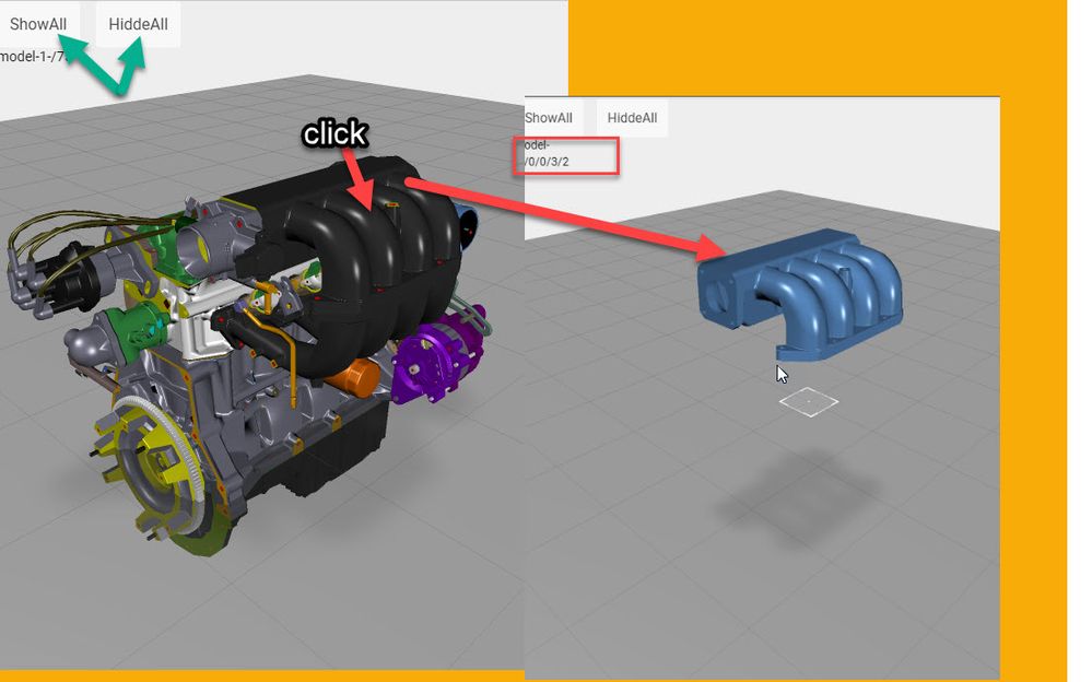

Ok, no problem.
Here an example attached. Please, click on an item:
Here it will hide all items and display only the selected one (with userpick event).
Please, let  me know if it is clear now. Thanks!

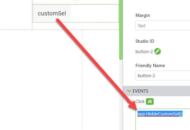

according to my  last post - and the mentioned there strategy - to make all component items hidden and then make only  the desired items visible. I the last post the example showed how it works with explicit defined model Item widgets. If you have an modelWidget without  explicit definition of modelItem widgets then you can use  the following sample code to make all items invisible /hidden . Later you can make visible only the desired items.
$scope.app.HiddeCustomSel= function(){
let pathDepth=4
let modelWidget='model-1'
let hidden = true
 $scope.app.testCustomSelection(modelWidget,$scope.app.whereFunc,$scope.app.selectFunc,pathDepth,hidden)

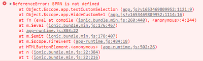

Sorry, I suppose there is some typo or mistake in your code. Can you please check?
thank you
Hi @GianVal , I am sorry yes it contains some code which is not required, cleaned it up

This code was tested in the project (it is another topic but I tested the button CustomSel there in the Home.json view) https://community.ptc.com/sejnu66972/attachments/sejnu66972/studio/10896/1/eulerTransformRotationCommunity_V03.zip
sorry, I can't get the point of your code. how can I choose the part to not hide? thank you
Ok, no problem.
