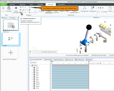

  2. you need creo illustrate and import the assembly (PVZ recommended)
  3. create minimum 1 figure with an animation, type sequence
  4. import the FRA file into the sequence step
  5. create a new step and import the next FRA file (repeat this for every FRA file)

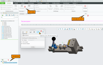

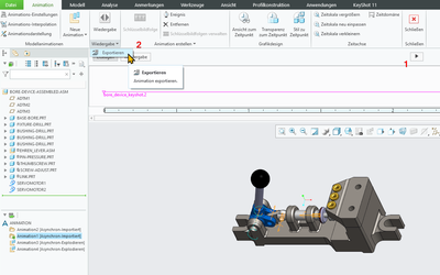

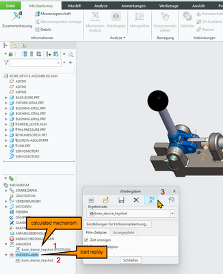

  • how to export FRA files:
    in animation, you would use → mwodarz_INNEO_0-1767943227353.png or mwodarz_INNEO_3-1767944355497.png
    It is not necessary to use "design animation" only to animate the mechanisms (just export the FRA files and do the rest in Illustrate)
