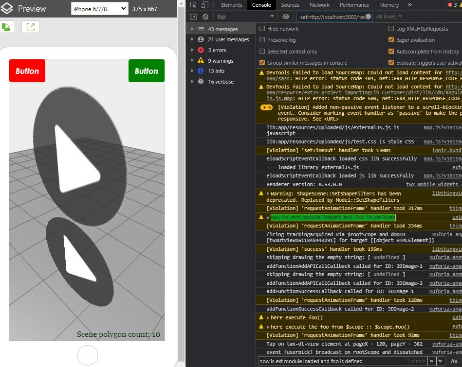

I tried these, but it is not working. What I've done wrong?
Vuforia Studio home.js
$scope.loadjscssfile= function(filename, filetype){
 console.log("loading "+filename+":: type="+filetype)
 if (filetype=="js"){ //if filename is a external JavaScript file
 var fileref=document.createElement('script')
 fileref.setAttribute("type","text/javascript")
 fileref.setAttribute("src", filename)
$scope.$on('$ionicView.afterEnter', function() {
 $scope.loadjscssfile("app/resources/Uploaded/js/externalJS.js", "js")
$scope.cnslTxt = val => console.log(val);
Widget Event Click JS
cnslTxt('external javascript')
Even I change the function to app.cnslTxt, not working still.
January 28, 2021
Here is a sample project which is working fine  and  where I loaded css and js -  e.g. the simplepicker lib to the project – so for  this was working fine. I have no idea why this is not working in your case  - I will check today or tomorrow your project to see if I have any ideas why this is not working in your case. I believe - may be some additional references are required ... but as mentioned need to check this first if there are some hints printed as error in the console window
January 29, 2021
Hi, @LS_9776545
This could be an easier approach.
For any function declared like this, could be called from any other View in the same Project.
$scope.app.functionName = function(){}
Therefore, it is possible to create some Views to separate codes.
