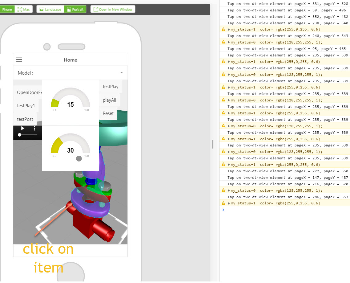

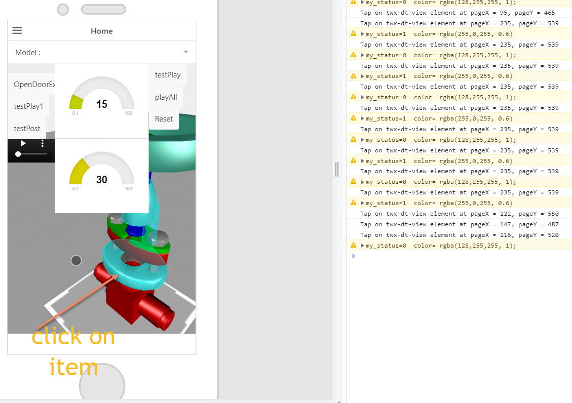

So I set the color property of specific model item and   defined a function which was applied of the click event of the modelitem .  Clicking on the model item will change now the color:
It will switch between old and new color
Here the whole relevant  code what I used to test the problem:
