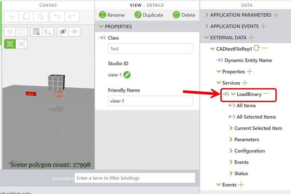

I have an issue that is happening in 1 of 2 servers.
I would like to dynamically load a model from a file repo thing in Thingworx on public mode.
In 1 server, it works correctly but on the other it does not and prompts me for a login instead of loading the file.
I have checked and the permissions seem to be correct, as do the app keys. I was successfully able to get a property to display correctly and to trigger a service on the file repo thing to show a string  without it prompting me for a login but when I try to load the pvz dynamically it prompts me for a login.
The FileRepo Thing permissions are correct, as are the datatable and the standard permissions needed.
Is there an additional back end permission required to download a pvz?

But what I think is more relevant point is to add the used  TWX services in the Vuforia Studio External data section. I tested it with different services and it will not work (also when all TWX permission are set correctly ) when the called services are not added in the Studio External data section:
anyway when you follow the suggested techniques described in Vuforia Studio Help : Create an Experience with Dynamic Model Loading it should work
Another point I remember if you connect to 2 different TWX objects  and you are using services with the same name -e.g. myTestSrv  - when you have this case and you added  services 2 times from different objects  - it internally Studio will rename the second service as myTestSrv_2 or _3 when 3 times ans so on .. but Vuforia Studio will display myTestSrv - so you need to call the correct service in that case.myTestSrv_2 in the JS code or in complete service all.

Thank you for all your help. I was able to work with a colleague to find a solution that worked.
1.CS264349 - Error "ApplicationKey Is Not Allowed As A URL Parameter" received while trying to use an Application Key in a URL to run a ThingWorx Service I had to go to the platform subsystem and allow it to use an application key as a url parameter
2. I added the es-public-access url to the download link that I was creating in my service. It looked like:
jsonlink=jsonlink +'?<appkey>';
That allowed this experience to work on both servers without prompting the user for a login.
Thank you again for your help
